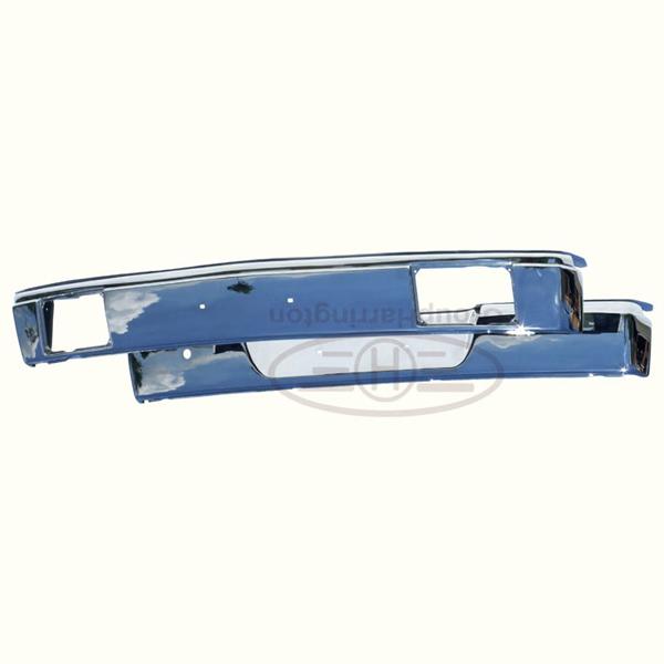

Somebody already makes those ... (IMG:style_emoticons/default/popcorn[1].gif)
!!! LINK REMOVED DUE TO INJECTED VIRUS ON THAT PAGE !!!
http://www.914world.com/bbs2/index.php?showtopic=108722
(IMG:http://www.914world.com/bbs2/uploads_offsite/www.groupharrington.com-179-1321681501.1.JPG)
