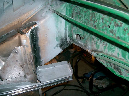

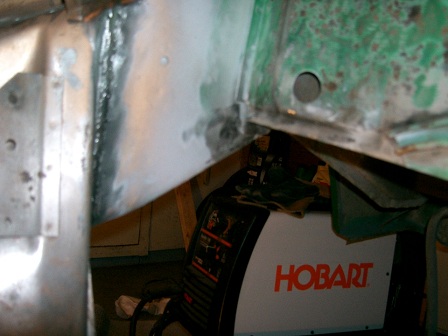

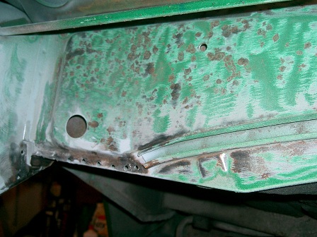

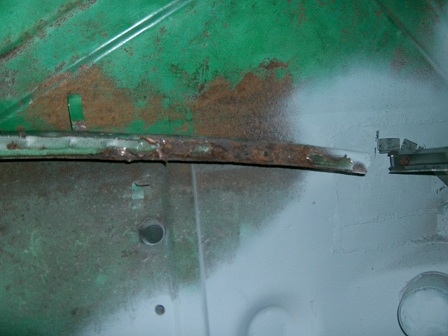

Finally got my new inner long welded in with doubler plates on all seams. Verified the incline of the new long with an incline gauge (with the car level) following Jeff Hails build thread. Door operates well! Entire inner long has been coated with rust encapsulator.
Still have a long way to go but I am hoping that this was the toughest part.
Thanks to Scotty B, Jeff Hail, and everyone else who has posted a build thread on this topic. I have read all of them & learned a lot. (IMG:style_emoticons/default/beerchug.gif)

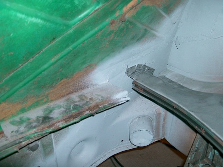

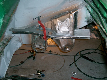

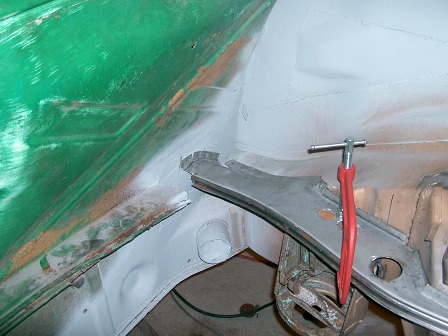

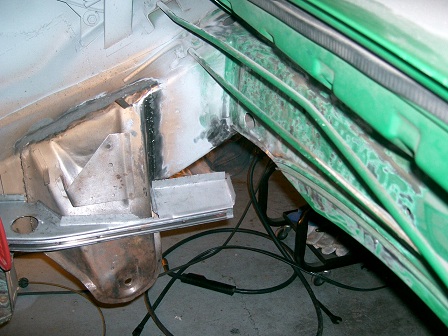

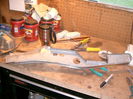

Fitted the engine shelf yesterday & today. This piece caused me a lot of frustration, largely because the front and rear firewall sections that hold the engine seal channel were not there to index from.
I got nervous that the engine mount was welded in too high, so I leveled the car and took measurements from the floor to the bottom of the mount. Driver and passenger side both came in at exactly 12". Additionally, I double checked all other measurements on the engine mount. Everything was good.
The shelf itself needed to be flattened a bit in the front where it meets the inner long. I also had to adjust the top edge of the engine mount in the front where I had welded a repair in.
I will need to fabricate both front & rear firewall metal to tie them into the engine shelf. Waiting until these pieces are made until I start welding anything. Filled holes in the rear firewall left from removal of the old sheet metal.
