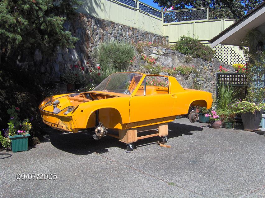

cwpeden
post Nov 21 2011, 01:19 AM
Great White North, huh?
Posts: 916
Joined: 20-August 06
From: Victoria BC
Member No.: 6,693
Good luck with the fix Steve. Mine looked like yours for 4 years after metal work. Dont loose momentum.
Dolly should be strong enough. Mine went about 15 miles and it looks weaker than yours. The hard part was moving it up the Flatdeck on 4 casters.
