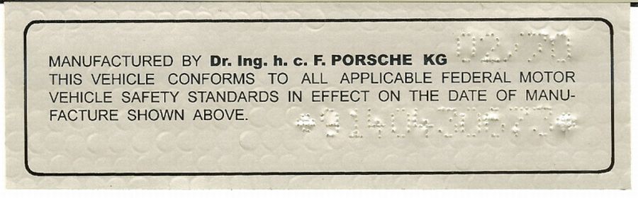

Has anyone had any luck getting replacement door jamb stickers with the vin number and build date imprinted? Years ago, I purchased a replica from Auto Atlanta, but have never been able to figure out how to imprint the sticker with the proper information. These days with computers and Photoshop, there must be a better way than to just try to do this freehand, but it's beyond my abilities,
Any help or information would be much appreciated. My 914-6 was repainted about 20 years ago, and people didn't worry about such things back then (or at least my body shop didn't).

I understand the Legal argument, but I don't think it applies. In a lot of cases, there is no longer a Sticker there.
Can you get one from Porsche, Yes- but it is incorrect
Can you a Blank from AA, Yes, but it is not Punched or Embossed
Blanks are available Cheaper than AA
The embossing ( Semi-Circles) is a bitch and is tough to get in a perfectly line, but can be done with a 5mm Biopsy Tool
The Punching of Numbers - I've heard of Threads of the Bank Check Machines, but I've never read one.
It can be done by hand, but

Socalandy   So I think I have what it takes to do this but nee...   Nov 23 2011, 08:46 PM

Socalandy   OK, It can be done and I'm working on a fixtur...   Jan 7 2012, 12:12 AM
Cairo94507   Wow you are definitely on to something there. Kee...   Jan 7 2012, 08:08 AM
Socalandy   I'm really happy this is working, I overlayed ...   Jan 7 2012, 09:12 AM

Socalandy   Update!! I've been looking into a bet...   Jan 20 2012, 04:51 PM

Socalandy   I spoke with Rory yesterday and you can see his po...   Jan 21 2012, 09:28 AM
