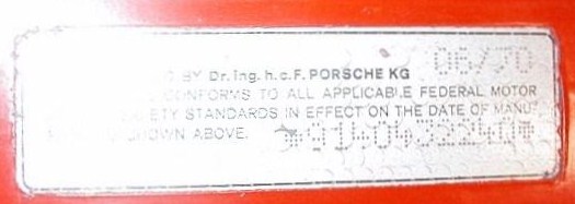

Socalandy   OK, It can be done and I'm working on a fixtur...   Jan 7 2012, 12:12 AM
Cairo94507   Wow you are definitely on to something there. Kee...   Jan 7 2012, 08:08 AM
Socalandy   I'm really happy this is working, I overlayed ...   Jan 7 2012, 09:12 AM
