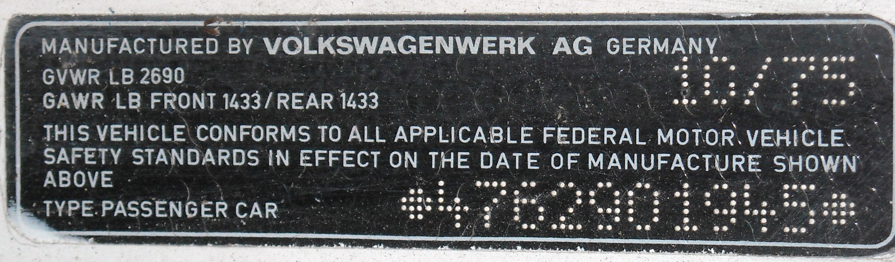

Has anyone had any luck getting replacement door jamb stickers with the vin number and build date imprinted? Years ago, I purchased a replica from Auto Atlanta, but have never been able to figure out how to imprint the sticker with the proper information. These days with computers and Photoshop, there must be a better way than to just try to do this freehand, but it's beyond my abilities,
Any help or information would be much appreciated. My 914-6 was repainted about 20 years ago, and people didn't worry about such things back then (or at least my body shop didn't).

How close are these replacement stickers to the original? My car is a 4 and is black. Are these available? I am assuming the one shown is for a 6 and I cannot compare it. A punch could be fairly easy to make.
Here is one of mine, you guys are going to hate me, I had one of those old Bank machine, and old girl friend was a VP at a local bank and when they updated, she gave me a bunch of the old stuff (mostly lights & clock, but a few other bits too) but I have no clue where it is right now (IMG:style_emoticons/default/sad.gif)

Socalandy   OK, It can be done and I'm working on a fixtur...   Jan 7 2012, 12:12 AM
Cairo94507   Wow you are definitely on to something there. Kee...   Jan 7 2012, 08:08 AM
Socalandy   I'm really happy this is working, I overlayed ...   Jan 7 2012, 09:12 AM

Socalandy   Update!! I've been looking into a bet...   Jan 20 2012, 04:51 PM
Cairo94507   No problem at all. I like better quality anything...   Jan 20 2012, 06:14 PM
charliew   I thought abought cutting the metal out on a bug a...   Jan 21 2012, 09:10 AM
Socalandy   I spoke with Rory yesterday and you can see his po...   Jan 21 2012, 09:28 AM
