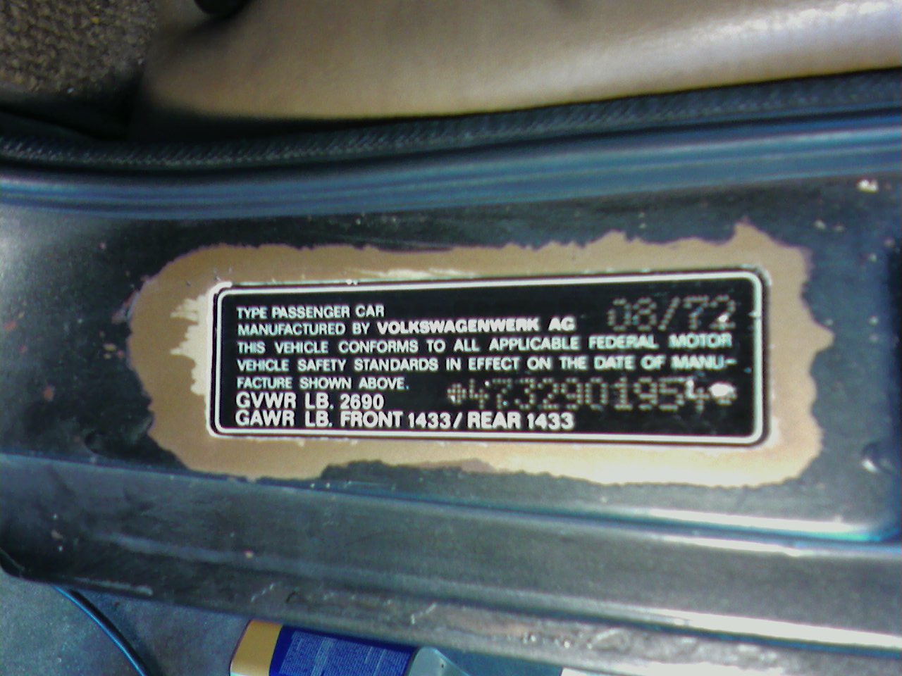

Has anyone had any luck getting replacement door jamb stickers with the vin number and build date imprinted? Years ago, I purchased a replica from Auto Atlanta, but have never been able to figure out how to imprint the sticker with the proper information. These days with computers and Photoshop, there must be a better way than to just try to do this freehand, but it's beyond my abilities,
Any help or information would be much appreciated. My 914-6 was repainted about 20 years ago, and people didn't worry about such things back then (or at least my body shop didn't).

Same black with punched letters type was used on my 8/72 built 73 914-2.0 -
AA sells one that looks just like this, but blank; and from one of the posts above it sounds like their are other sources for them as well.

Socalandy   OK, It can be done and I'm working on a fixtur...   Jan 7 2012, 12:12 AM
Cairo94507   Wow you are definitely on to something there. Kee...   Jan 7 2012, 08:08 AM
Socalandy   I'm really happy this is working, I overlayed ...   Jan 7 2012, 09:12 AM

Socalandy   repro I got from Ebay, I dont know how many peeps...   Jan 7 2012, 02:51 PM

Socalandy   So I talked to my buddy with the etcher. We both w...   Jan 7 2012, 10:36 PM

Socalandy   Update!! I've been looking into a bet...   Jan 20 2012, 04:51 PM

Socalandy   I spoke with Rory yesterday and you can see his po...   Jan 21 2012, 09:28 AM
