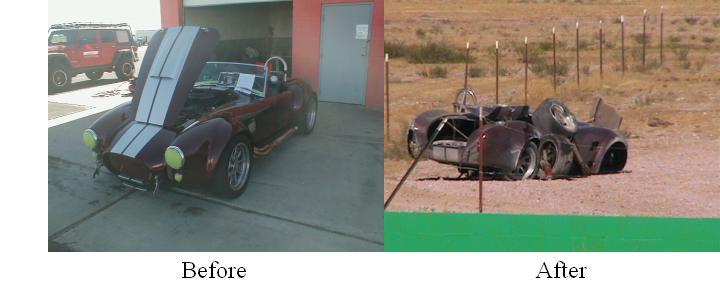

Not trying to derail your thread.
I just met the owner of this car that broke the inside front upper control arm just going into turn 1 at Willow Springs last month. He walked away (well, got checked out at the hospital) with no broken bones or lacerations. This is more the "push it off the cliff" type of accident. The car rolled multiple times and then went end over end. Very scary and pretty amazing. It turns out that the little roll bar is surprisingly effective.

"A man's got to know his limitations". (IMG:style_emoticons/default/laugh.gif)
