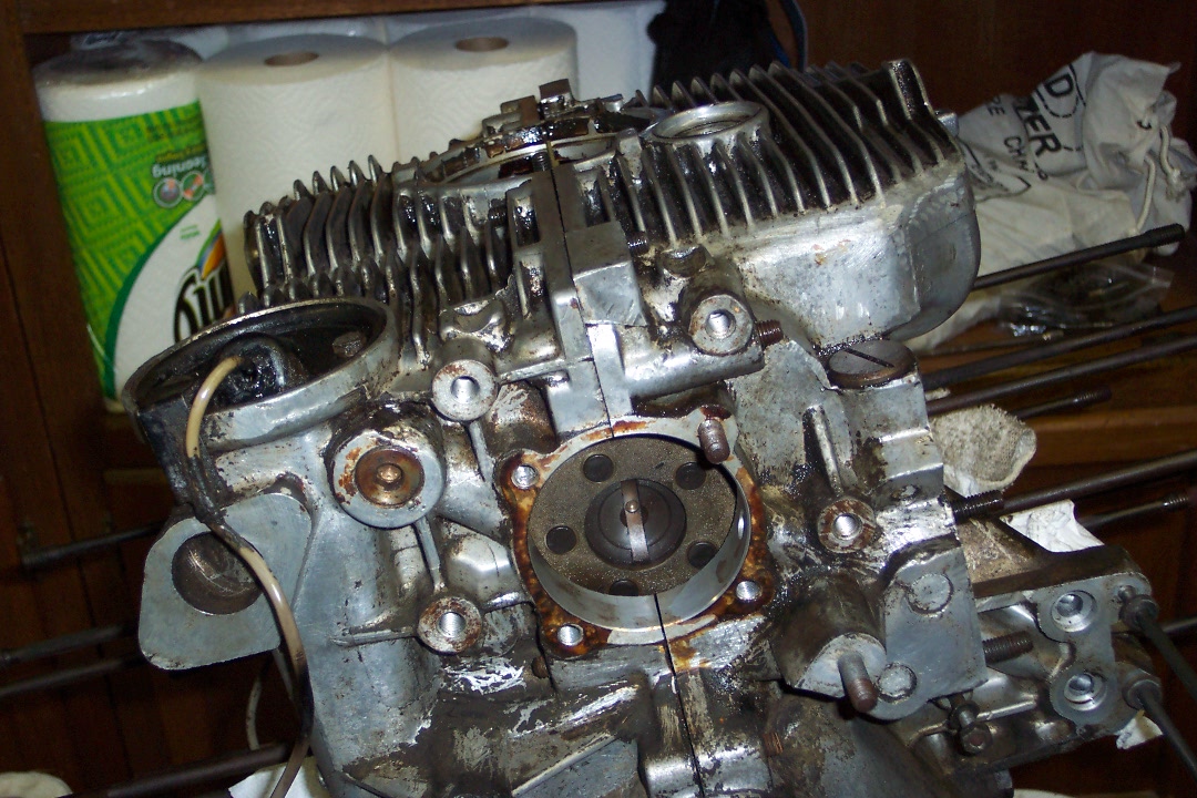

I broke the seal from the crank and it broke everything loose except the dowel underneath the oil cooler on the lower side of the engine.
How do I pull this area apart? |

Here's a bloody pict....

Vacca Rabite Find the bolt you missed.

RobW Didn't miss any.... unless there's one ins... Nov 25 2011, 07:06 PM
RobW Everything is free except the 90 deg underneath th... Nov 25 2011, 07:18 PM
bigkensteele Isn't there one around the oil filler console ... Nov 25 2011, 07:29 PM

Isn't there one around the oil filler console... Nov 25 2011, 07:35 PM
Van Probably dealing with some corrosion on a dowel pi... Nov 25 2011, 07:58 PM

Mark Henry Is there still a couple of washers on the studs? T... Nov 26 2011, 08:46 AM
jsconst It could be sealant holding it together there, I h... Nov 26 2011, 09:18 AM

I carefully took a straight edge piece o... Nov 26 2011, 09:34 AM
Jake Raby After watching the video I'll say that you jus... Nov 26 2011, 03:04 PM![]() ![]() |
