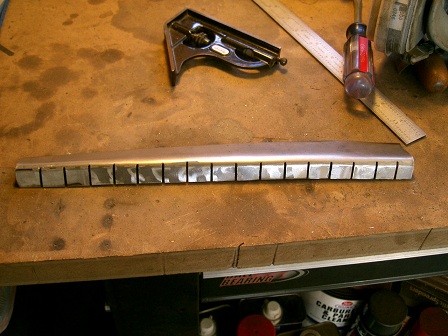

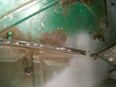

Got some more done today. Started treating rust on the front firewall engine shelf. Part of it is missing and some areas have a little rust - thru, so I fabricated a doubler that will be welded on the bottom. It will serve two purposes...beef up the remaining factory shelf and serve as a backer/support for the piece I need to fabricate to tie in the passenger side engine shelf. I had to make relief cuts every 3/4" so I could match the factory bend:

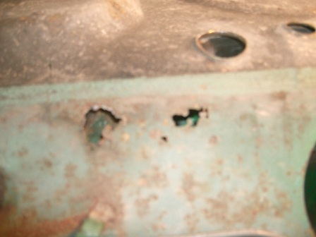

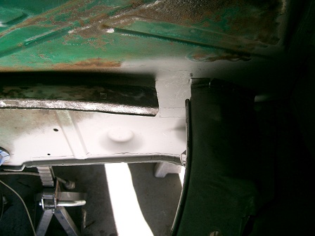

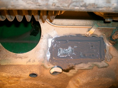

There were a couple of small holes under the gas tank on the passenger side that needed to be patched. This will not be a show car, just a fun, reliable daily driver. I cleaned the area, fabricated a doubler for the bottom, rosette welded it on and sealed the edges with JB-Weld:

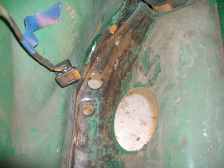

saigon71   Found another large spot of rust where the front t...   May 17 2011, 07:23 PM
mepstein   Found another large spot of rust where the front ...   May 17 2011, 07:53 PM

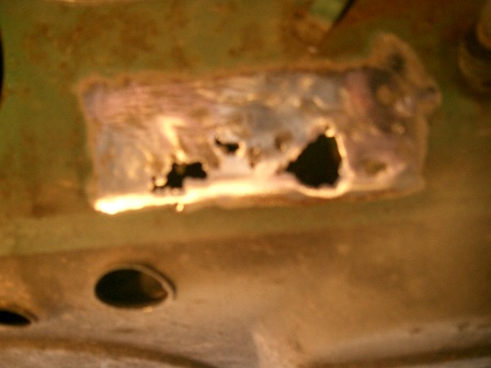

saigon71   DAMNIT!!! After filling about 7 roset...   May 30 2011, 07:48 PM
