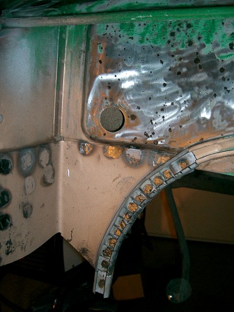

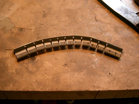

Welded the engine bay seal channel on the rear firewall. This product was not available pre-bent from Restoration Design, so I had to make relief cuts to get the proper bend:
Treated the rear driver side engine shelf with ospho:

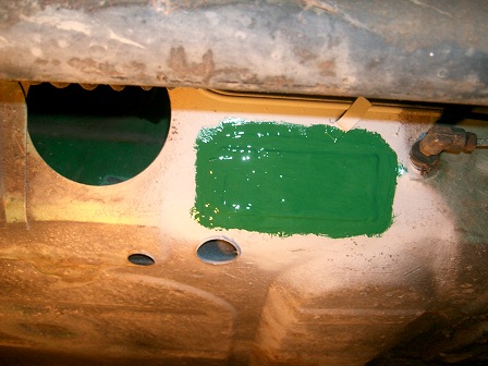

Brushed two top coats of acrylic enamel on the patch panel, passenger side under the gas tank:
