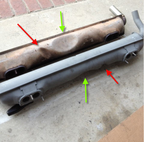

So it bolts up fine to the heat exchangers, but when I bolt the tip on. It angles too far upward and I hits the rear of the car. I bought this from a seller saying it was for a 914. But I think it might be for ?? Mis-built and that was by it was sold ??
Let me know who you think.

Note the indentations in the middle of the muffler. If I flipped the Dansk muffler those indentations would match up with my original muffler and the tip would be on passenger side.

moparrob   For a bus?   Nov 27 2011, 07:34 PM
Elliot Cannon   Cut the exhuast tip off close to the flange. Re-p...   Nov 27 2011, 07:38 PM
pete-stevers   reweld or send it to me   Nov 27 2011, 07:40 PM
Mark Henry   It's a bus muffler 72-77 Don't cut the fl...   Nov 27 2011, 07:46 PM
Cap'n Krusty   It's a bus muffler 72-77 Don't cut the f...   Nov 27 2011, 09:43 PM
Mark Henry   Sorry I thought you guys meant cut the other flang...   Nov 27 2011, 07:49 PM
Montreal914   Here are images from the AA catalog and from the w...   Nov 27 2011, 08:08 PM
porsche913b_sp   Yes it clears the trans, bolts right up no problem...   Nov 27 2011, 08:58 PM
a914dude   Re welding the tip isn't a big deal.   Nov 27 2011, 09:02 PM
McMark   :agree: reweld the tip, or take it to a muffler sh...   Nov 27 2011, 09:07 PM
porsche913b_sp   Note on the Dansk muffler the narrow side of the f...   Nov 27 2011, 09:16 PM
rock914   I purchased the same muffler, mine came with two d...   Nov 27 2011, 09:29 PM
nathansnathan   Seems like someone really screwed up making that m...   Nov 28 2011, 07:59 AM
porsche913b_sp   Note the indentations in the middle of the muffler...   Nov 28 2011, 01:33 PM
nathansnathan   But no matter what heater box you attach it to, it...   Nov 28 2011, 02:45 PM
Dave_Darling   That last muffler is an original-style 1.7 one. T...   Nov 28 2011, 07:59 PM
nathansnathan   That last muffler is an original-style 1.7 one. ...   Nov 28 2011, 10:58 PM
bradtho   I had the same problem with my 1.7 w/ the original...   Nov 29 2011, 09:58 PM
hwgunner   Here is a picture from one of my distributors that...   Nov 29 2011, 11:00 PM
