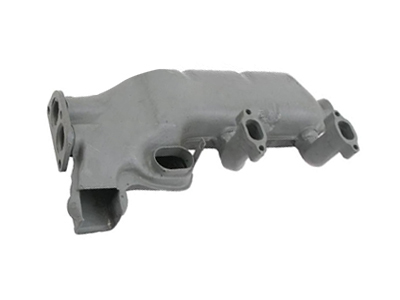

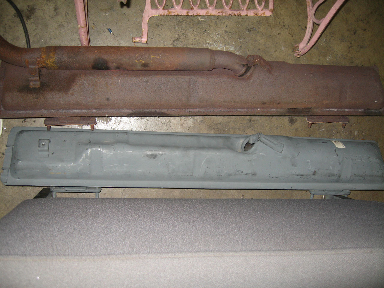

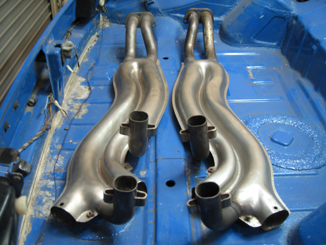

But no matter what heater box you attach it to, it has to go with the single hole on the top, the double on the bottom. Seems the only good option is to re-weld the tailpipe.

A real 914 muffler the tailpipe exits from the middle, and the tailpipe goes to the driver side.
(IMG:http://www.914world.com/bbs2/uploads_offsite/www.eggscollective.org-11782-1322513133.2.jpg)
