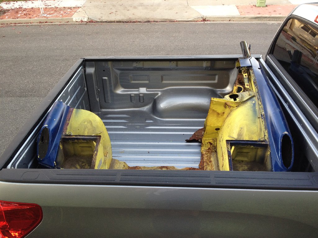

Finished the tear down this past weekend and got the car to EAB today. Adding some straps and 180 pounds of concrete (still in the bags (IMG:style_emoticons/default/smile.gif) ), helped alot to make the car more balanced on the dolly.
I've also emailed Toyota and suggested they re-brand their bed options as: (a) long bed, (b) standard bed, and © 914-width bed. I haven't heard from them yet.
