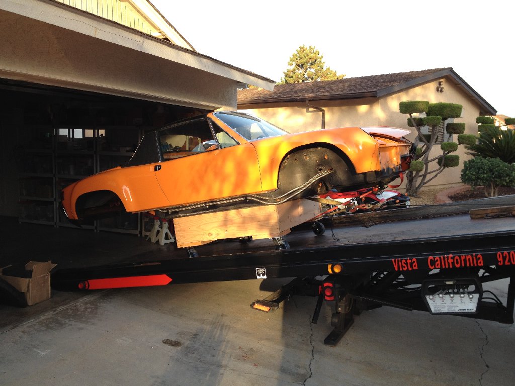

siverson   Finished the tear down this past weekend and got t...   Nov 28 2011, 10:03 PM
siverson   At this point, I was 70% sure I was going to show ...   Nov 28 2011, 10:05 PM
siverson   But it worked out ok. -Steve   Nov 28 2011, 10:06 PM
siverson   Hopefully it will be back together when he's r...   Nov 28 2011, 10:08 PM
