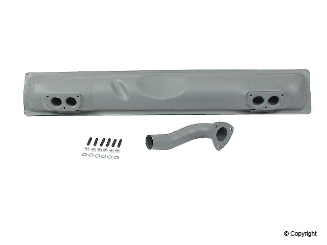

So it bolts up fine to the heat exchangers, but when I bolt the tip on. It angles too far upward and I hits the rear of the car. I bought this from a seller saying it was for a 914. But I think it might be for ?? Mis-built and that was by it was sold ??
Let me know who you think.
Thank you.

Here is a picture from one of my distributors that calls this muffler out for a 1.7 914. Dansk may have it wrong or it may be the dist. that has not been paying attention. The part number for the pictured muffler is 021 251 053 C.
