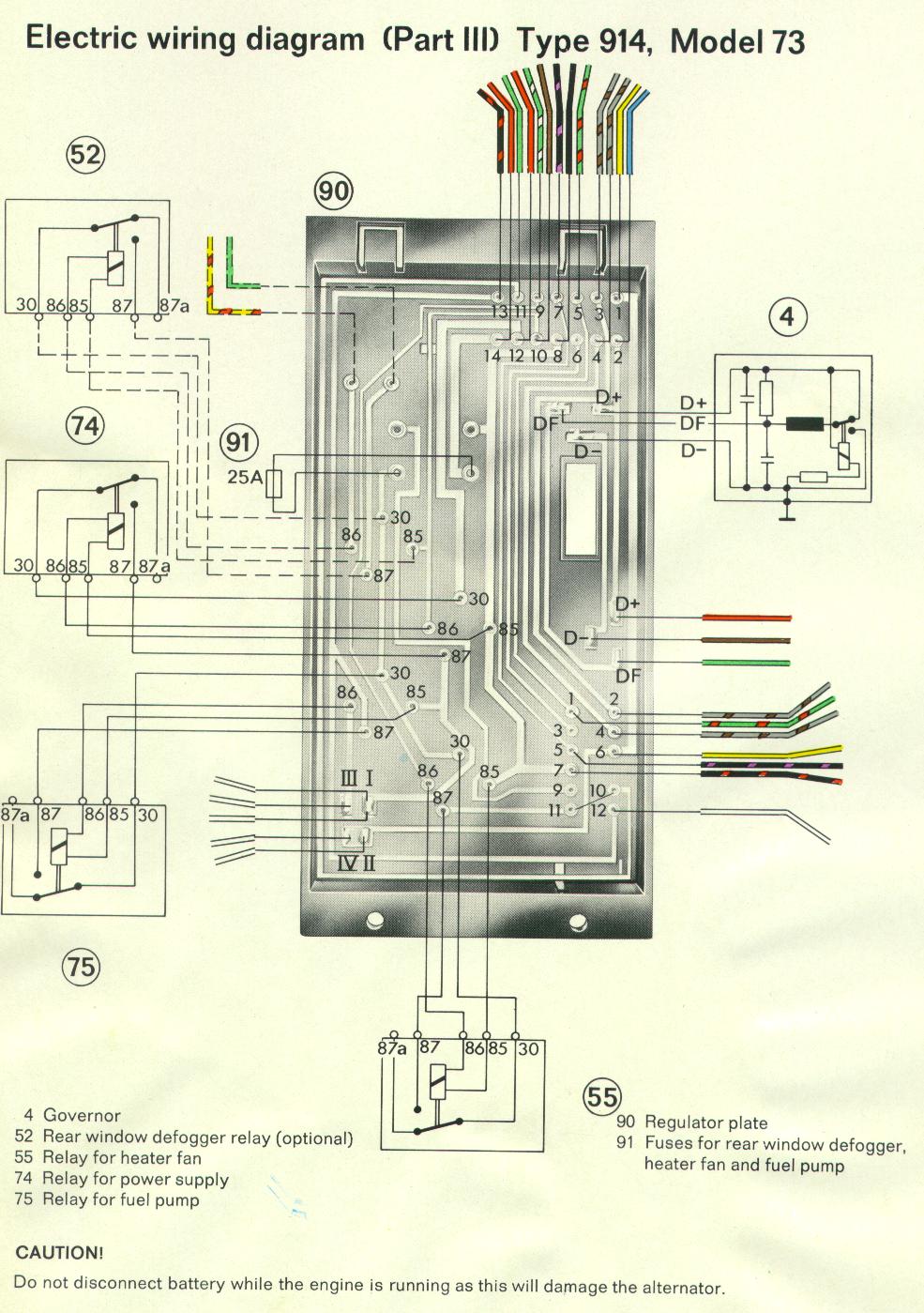

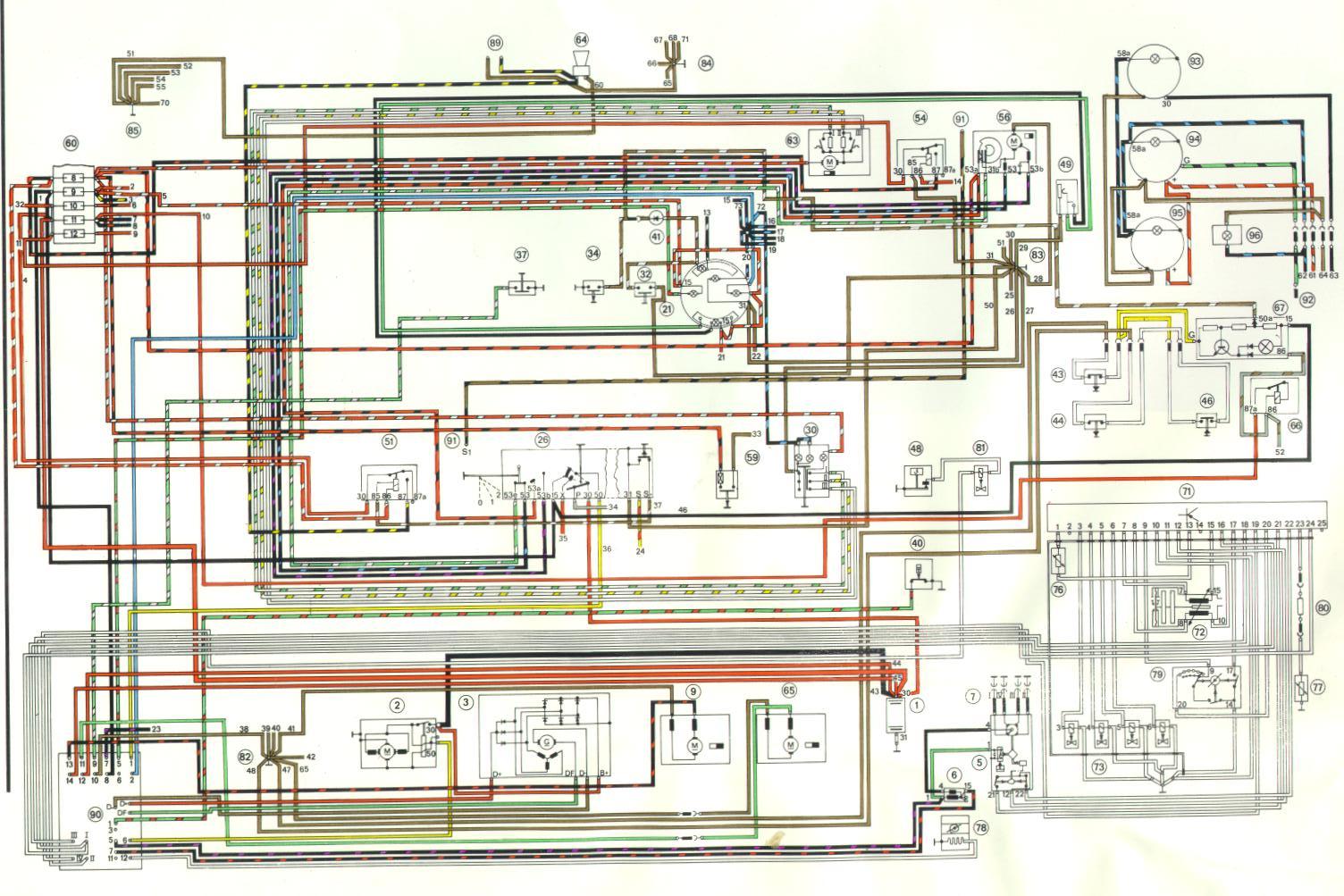

If you click on the picture you will get a clearer picture

rick 918-S   If you click on the picture you will get a c...   Nov 30 2011, 09:50 PM
