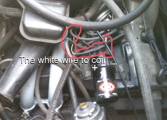

Thanks jcd914 As you said, no white wire on coil w/ 1.7 D-Jet...
I spent quite a while tonight researching any post about a white wire on coil and came up with the L-Jet 1.8 using that white coil wire to trigger FI pulses (914club forum)... No reference to a 1973 D-Jet 1.7L... so off it comes to remain disconnected...
BTW: When that white lead is connected to the + power side of the coil the fuel pump runs constantly, hope that tells someone something.
Sure hope it still runs with the white wire off the - coil terminal...
I'll let you all know.........

Thanks SLITS, the starter circuit info is really helpful. BTW, white wire to AAR is present and hooked up. The white wire I'm referencing is off the FI harness near the coil. Doesn't show in any 1.7L wiring diagram.. weird deal...
Below I have posted a wider perspective photo of that white wire...
Stay tuned Gentlemen.... more detail to follow asap... Best, Broz97
