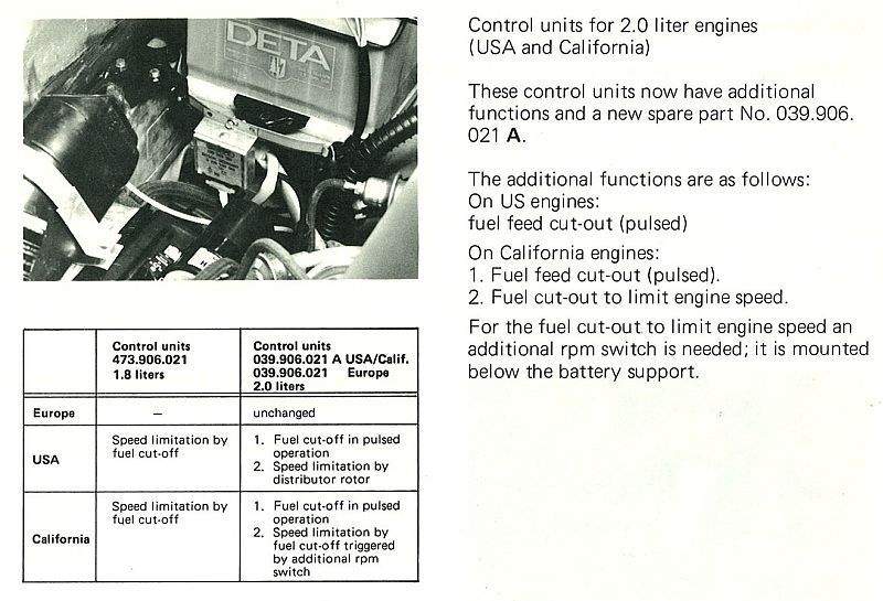

On the latest cars (late 75 & 76 2.0L) the Brain/harness came with an additional logic circuit plugged in to a connector near the MPS.
What was this for? (IMG:style_emoticons/default/idea.gif)
Would the car run w/o it? (IMG:style_emoticons/default/confused24.gif)

This circuit was actually a 1975 & 1976 'feature'. See this from the 1975 S&T manual, no similar manual was published for the 1976 cars.

Jeff Bowlsby   That's a CA-only speed limiter circuit...detai...   Dec 4 2011, 06:21 PM

PancakePorsche   Speed control module limits rpm by shutting down i...   Dec 4 2011, 08:16 PM

Dave_Darling   Possibly: 49 state cars used rev limiting rotors w...   Dec 5 2011, 06:57 PM

blitZ   I have a California 76 car and it had the silver b...   Dec 5 2011, 06:56 AM

r_towle   What is the engine speed limit? How does this work...   Dec 5 2011, 01:44 PM
Jeff Bowlsby   What is the engine speed limit? How does this wor...   Dec 5 2011, 02:07 PM
PancakePorsche   If I had to guess it shunts trigger point signal t...   Dec 5 2011, 07:31 PM
Jeff Bowlsby   Here is the circuit. It senses the trigger points...   Dec 5 2011, 07:33 PM
