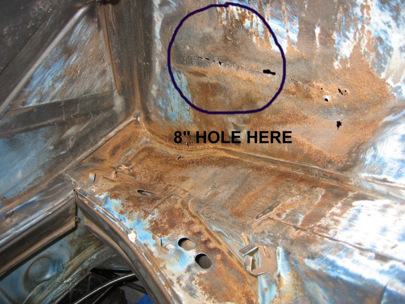

Give it to me straight guys how bad is this? (IMG:style_emoticons/default/unsure.gif)
Should I replace all of the panels or is there an alternatve? There is a small 3/8 hole in the top of the frame member but there is NO rust on the bottom side of the car (jack point/suspension mount).

I am almost done with thewelding rust repair in this area and I have another question.
I am adding a Permacool oil cooler to the car and was wanting to cut a hole in the spot shown in the pic. The cooler will be mounted in the fenderwell as far forward as possible. The plan is to try to pull more fresh air into the engine bay and exaust it into the fenderwell.
Do you think this will physically hurt the car? Should I weld a plate around the hole?

Dave_Darling   How much do you like this particular car? How muc...   Apr 2 2003, 12:46 PM
SirAndy   naaa, that's good! spray "Metal Ready" in ...   Apr 2 2003, 12:51 PM

Pompano Beach 914V8   Seems like no big deal, simple repair. I live on t...   Apr 2 2003, 01:31 PM
SirAndy   airsix is right. if you look at my second picture ...   Apr 2 2003, 01:31 PM

Dman   This is the only real rust on the car so I want to...   Apr 2 2003, 01:46 PM

Brad Roberts   The factory uses a similar hole on the other side ...   Apr 16 2003, 11:37 AM

Bleyseng   It will be fine unless you drive the car on the st...   Apr 16 2003, 06:02 PM

Dman   Elliot, I have been sceptical about Por-15 for a...   Apr 17 2003, 10:40 AM
