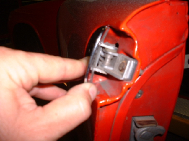

I am about to get working on my outer door handles. They both broke on the same day right before leaving to petit le mans, but in different ways.
On the drivers side I think it's the little plastic piece on the inside. On the passengers side the handle is loose due to the plate breaking. I have a new little plastic thingey and a new metal base for the other handle. Anyone with experience that is willing to offer any tips or suggestions will be rewarded in their next life. |

This is an old picture of the first one I fixed on my car. I use stainless steel nuts and bolts now,

dangrouche the driver side one should not involve drilling of... Dec 10 2011, 12:03 PM
URY914 Using sheet metal is OK until it rusts and runs do... Dec 10 2011, 12:14 PM

URY914 Ripper, be careful not to break the flapper part o... Dec 10 2011, 01:10 PM
ripper911 All went well, I got the handles fixed yesterday w... Dec 11 2011, 04:49 AM

ripper911 The drivers side handle is smooth as a greased mid... Dec 15 2011, 12:11 PM
URY914 Passenger side gets broken more often actually. La... Dec 15 2011, 12:59 PM
