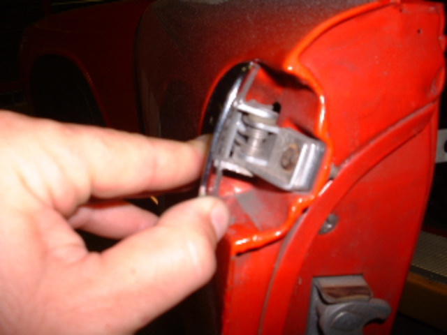

URY914
Using sheet metal is OK until it rusts and runs down your door. I've been doing this since I first fixed the one I broke in college. And that was a long time ago.
URY914
This is an old picture of the first one I fixed on my car. I use stainless steel nuts and bolts now,
ThePaintedMan
If you keep posting pictures I'm gonna get OCD and end up trying to do it myself Paul! Then I'll never end up coming to Tampa to see your car. Seriously, now I see how you've done it. Seems feasible. Just time consuming.
