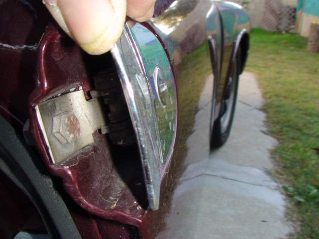

You may have broken yours the same place that I did mine.
I made a little steel clamp and used a nut and bolt. It took a drill, hack saw, little file work and bending a joggle. Works great. Attached image(s)

Niiiiccee! (IMG:style_emoticons/default/beerchug.gif)
You may have broke yours the same place that I did mine. I made a little steal clamp and used a nut and bolt. It took a drill, hack saw, little file work and bending a joggle. Works great. |

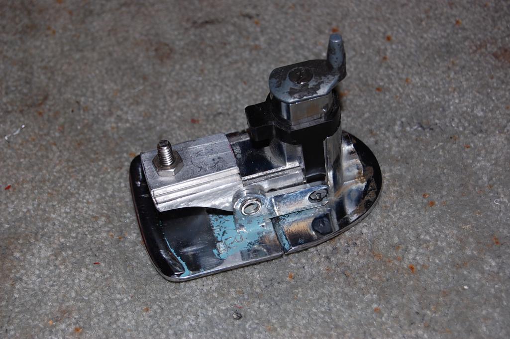

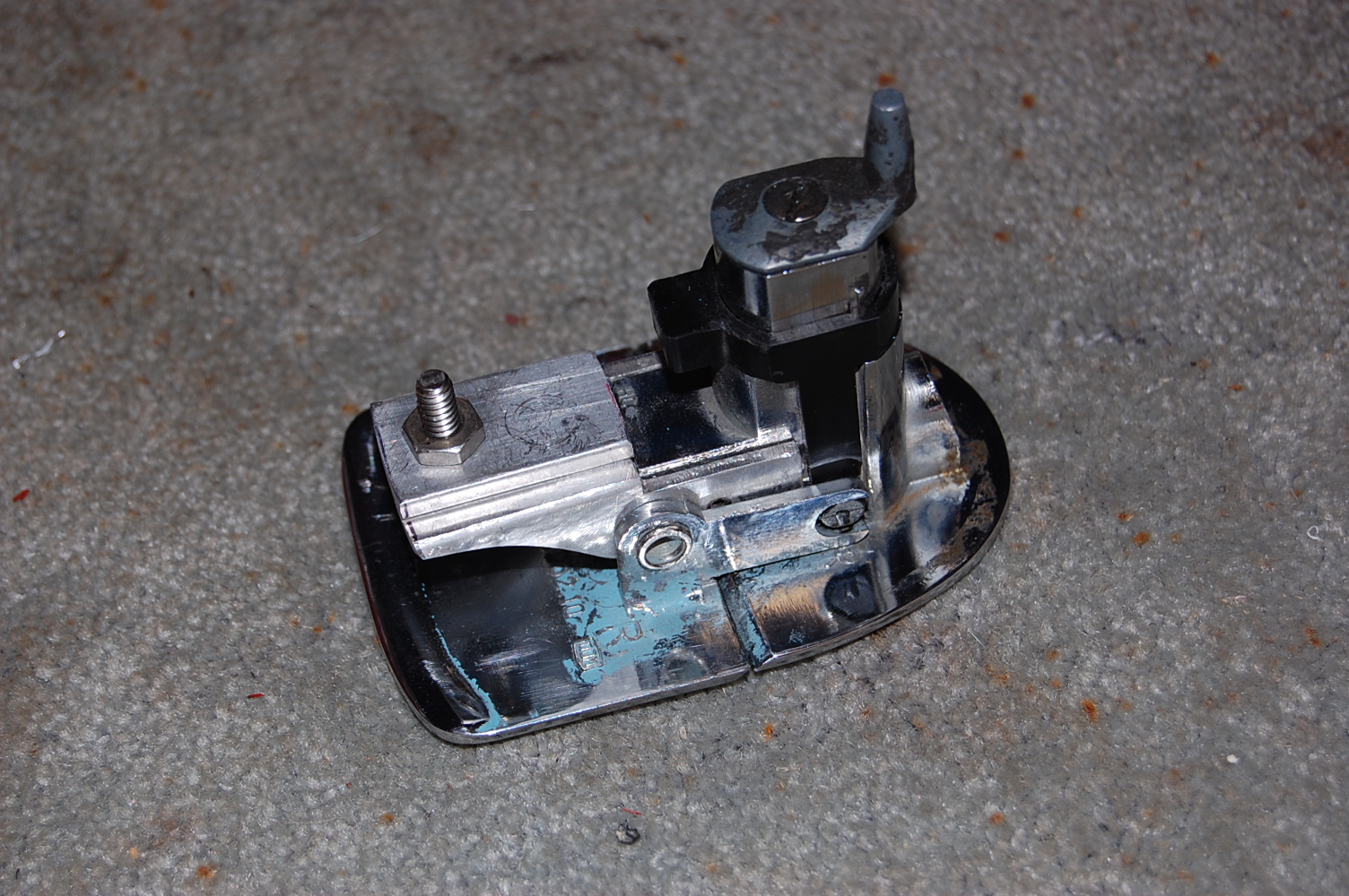

I built the lightest 914 in the history of mankind. ![]() ![]() ![]() ![]() ![]() ![]() ![]() ![]() ![]() ![]() ![]() ![]() ![]() ![]() ![]() ![]() ![]() ![]() ![]() ![]() ![]() ![]() ![]() ![]() ![]() ![]() ![]() ![]() ![]() ![]() ![]() ![]() ![]() ![]() ![]() ![]() ![]() ![]() ![]() ![]() ![]() ![]() ![]() ![]() ![]() ![]() ![]() ![]() ![]() ![]() ![]() ![]() ![]() ![]() ![]() ![]() ![]() ![]() ![]() ![]() ![]() ![]() ![]() ![]() ![]() ![]() ![]() ![]() ![]() ![]() ![]() ![]() ![]() ![]() ![]() ![]() ![]() ![]() ![]() ![]() ![]() ![]() ![]() ![]() ![]() ![]() ![]() ![]() ![]() ![]() ![]() ![]() ![]() ![]() ![]() ![]() ![]() ![]() ![]() ![]() Group: Members Posts: 132,624 Joined: 3-February 03 From: Jacksonville, FL Member No.: 222 Region Association: None |
This is an old picture of the first one I fixed on my car. I use stainless steel nuts and bolts now,

Advanced Member ![]() ![]() ![]() ![]() Group: Members Posts: 3,887 Joined: 6-September 11 From: St. Petersburg, FL Member No.: 13,527 Region Association: South East States
If you keep posting pictures I'm gonna get OCD and end up trying to do it myself Paul! Then I'll never end up coming to Tampa to see your car. Seriously, now I see how you've done it. Seems feasible. Just time consuming.
