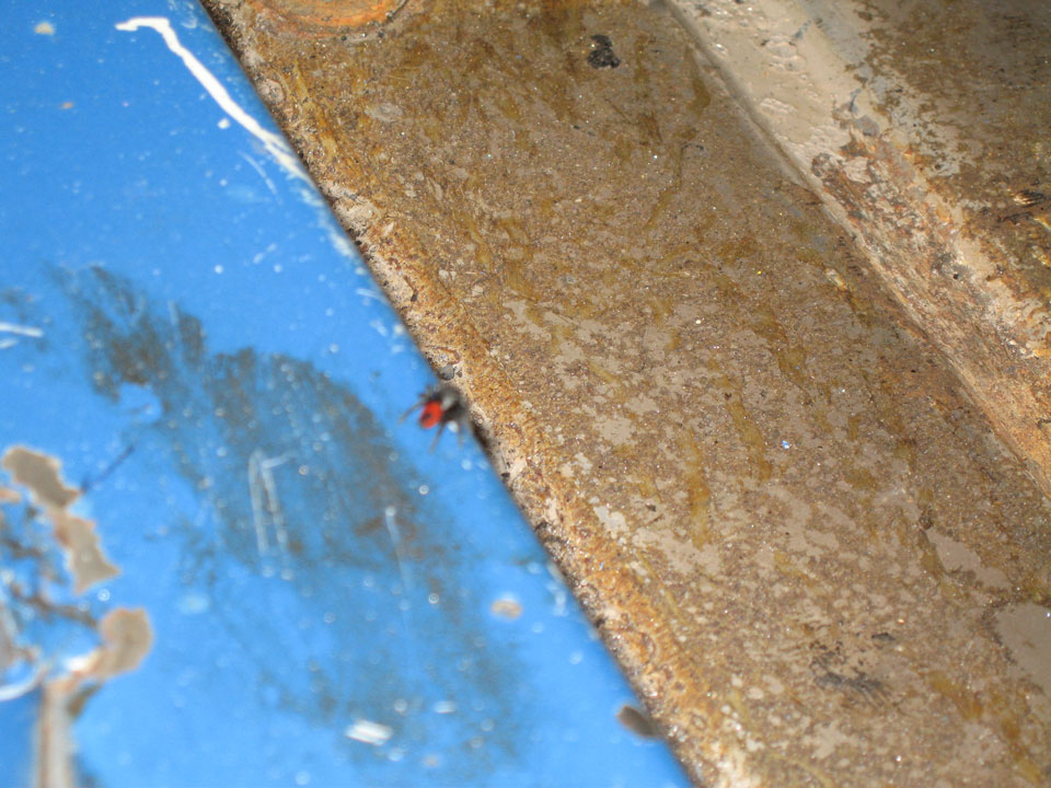

I cant add anything about the build other than "looks good, keep it up" but I know a little about self-surgery, I always like to get drunk first! Absinthe is great because it will numb you nicely while allowing you to keep focus, up to a point.
Also, I don't think that is a black widow. But, maybe thats a california black widow. (IMG:style_emoticons/default/cheer.gif)

(IMG:http://www.914world.com/bbs2/uploads_offsite/www.914club.com-11782-1296535789.11.jpg)
QUOTE(ripper911 @ Apr 5 2011, 09:52 PM) *
I think it's bit me, a brown widow, though. Their venom is twice as toxic as a black widow's but they inject less and it stays more localized instead of going to the whole body.

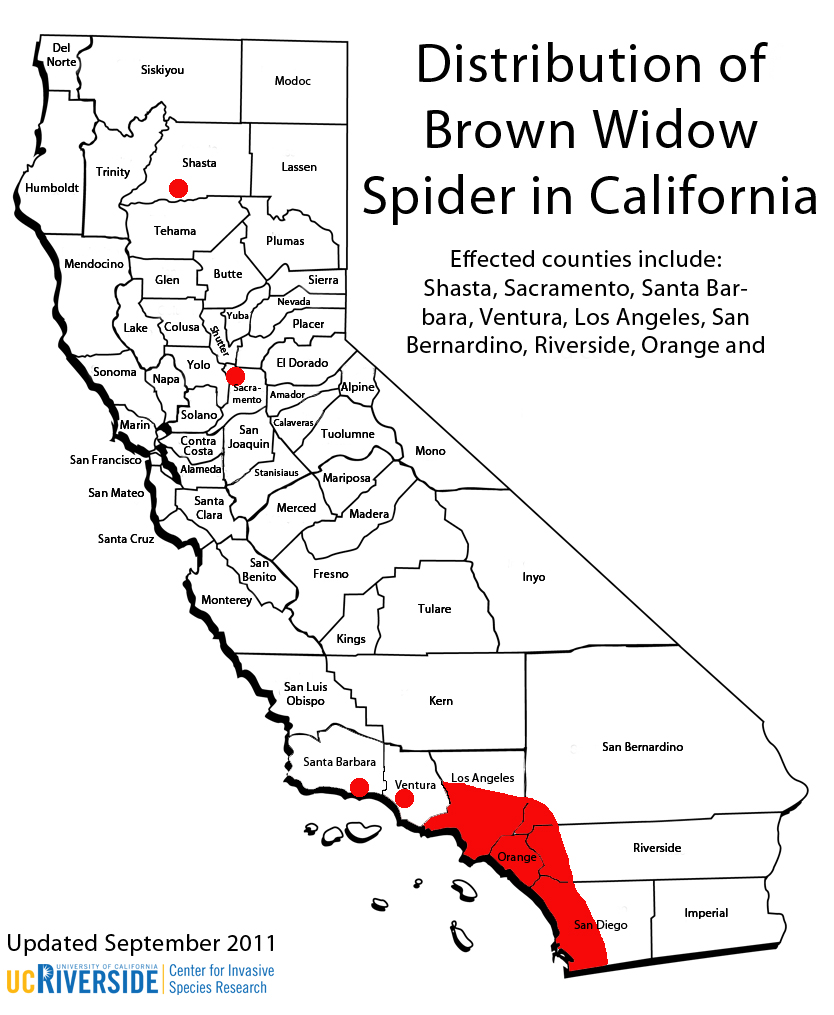

(IMG:http://www.914world.com/bbs2/uploads_offsite/cisr.ucr.edu-11782-1323582892.1.jpg)
That's me in the middle of that large red area. I felt the bump on Monday last week. I think it was in my overalls. I thought it might go away, the bump, but it spread, swelled up. I ended up at the hospital on friday, and again today for intravenous antibiotic injections, and will be back there again tomorrow. Unbelievable the amount of nasty ichor, pus? that I have witnessed spout from my arm. (IMG:style_emoticons/default/WTF.gif) (IMG:style_emoticons/default/head_hurts_kr.gif) (IMG:style_emoticons/default/wacko.gif) (IMG:style_emoticons/default/icon8.gif) (IMG:style_emoticons/default/sad.gif) (IMG:style_emoticons/default/ohmy.gif) (IMG:style_emoticons/default/smoke.gif) (IMG:style_emoticons/default/mellow.gif) (IMG:style_emoticons/default/cool_shades.gif)
I'd hoped to be putting in the long on my next post here but I have been unable to work with it going on. It is a bacterial infection, fever, shaking, headache, etc. I've got some shots of where it sits, fairly impressive with almost all of the inner long welded and the firewall and floor fitted up. I will post pics soon (of the car, not the wound (IMG:style_emoticons/default/biggrin.gif) )
