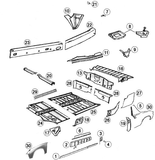

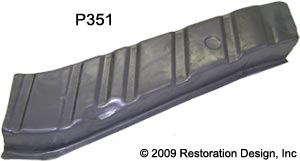

Thanks, guys for all the compliments/ encouragement. I really can't wait to get her together!
The way restoration design does the hell hole repair isn't the same as factory from what I can figure - they omit the outer piece so just the corrugated piece is used, which I didn't want to do. Like on their site, if you click on the image for '22'
(IMG:http://www.914world.com/bbs2/uploads_offsite/www.restoration-design.com-11782-1323634475.1.jpg)
you get this, which is the inner
(IMG:http://www.914world.com/bbs2/uploads_offsite/www.restoration-design.com-11782-1323634476.2.jpg)
Auto Atlanta has the whole shebang, 22 and 23 as 1 piece, from the factory, but for a whopping $3000! I did think about that but, ... no. (IMG:style_emoticons/default/biggrin.gif)

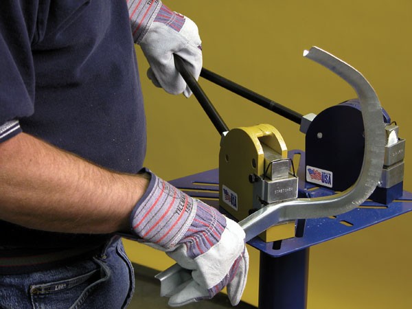

So I'm doing it the hard way. The tig is a big help. A shrinker stretcher would be nice, like what Eastwood has, though I don't like how it rough the metal all up, how it works.

QUOTE(nathansnathan @ Dec 11 2011, 12:14 PM) *
I'm pretty sure RD has both pieces. There was a thread about that a while ago.
They are pretty active here, PM peteyd if you have questions.
