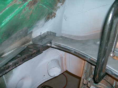

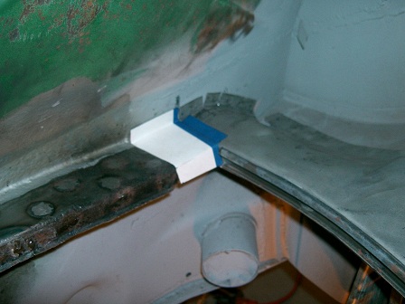

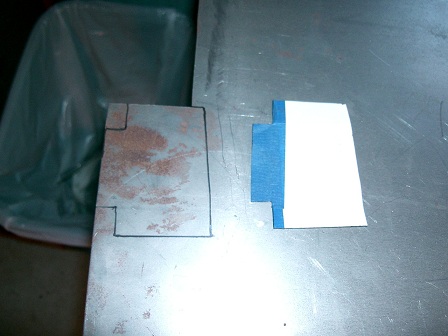

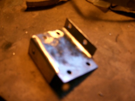

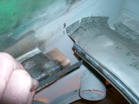

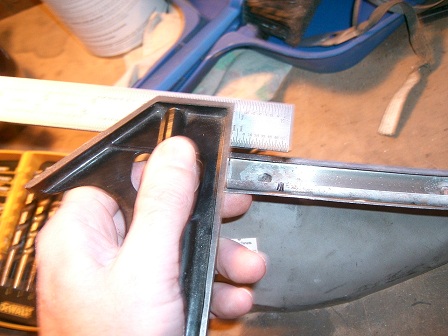

Got some quality shop time in today. Fabricated the connection piece that will tie the engine bay sheet metal together up front. Made a template and hammered out the piece I needed. I had to cut back about an inch of the engine bay seal channel on the replacement piece. A dremmel tool with a cut off wheel did a fine job:

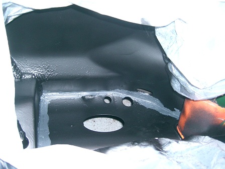

Hit the passenger area under the tank with ospho, two coats of rust encapsulator and new seam sealer:
