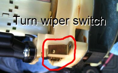

BTW... Another challenge when changing the ign switch was the brass clip which fell out of the turn / wiper switch assembly on the floor.... another hour of fun... for those that have inquired, and, I saw a few inquires on the various forums and no solutions... here is a pic of it installed... Yeah...
