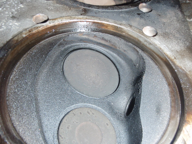

jsayre914   The numbers of the day.... Chamber 1 98 Cham...   Oct 11 2011, 01:04 PM
jsayre914   The numbers of the day.... Chamber 1 98 Cha...   Dec 15 2011, 01:04 PM
Vacca Rabite   You probably need the fuel pump, unless you still ...   Oct 11 2011, 03:53 PM
jsayre914   c'mon guys... Burnt valve? Broken valve? Sea...   Dec 16 2011, 03:04 PM
Vacca Rabite   I need the parts when you pull the engine, which I...   Dec 16 2011, 07:03 PM
Vacca Rabite   Oh, and the bum compression may be a valve seat th...   Dec 16 2011, 07:04 PM
Dr Evil   Are these #s on the same tired 1.8?   Dec 17 2011, 12:59 AM
messix   broken rings/ring lands will bleed off compression...   Dec 17 2011, 01:28 AM

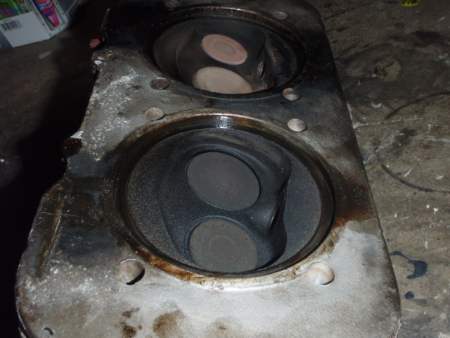

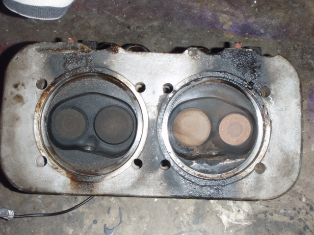

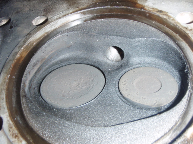

jsayre914   YUP! Im DONE !! This engine has retir...   Dec 27 2011, 08:22 PM
