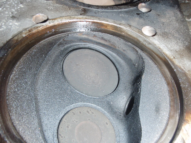

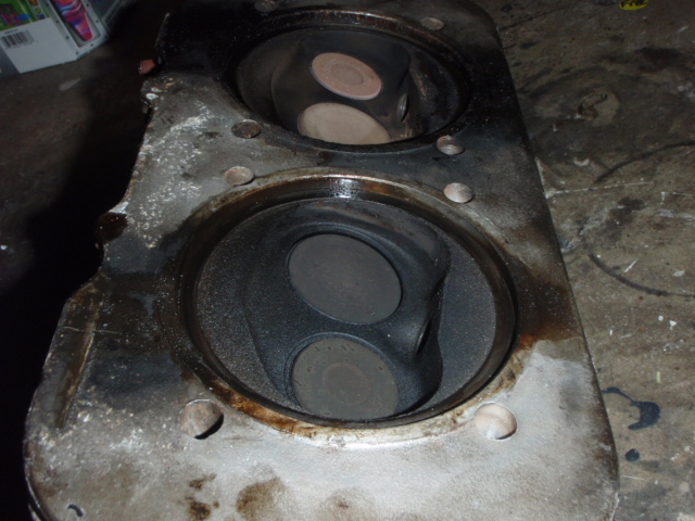

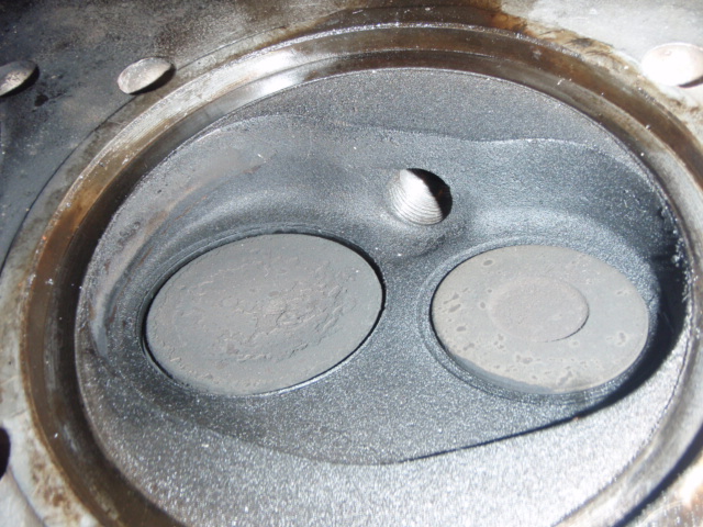

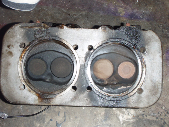

YUP!
Im DONE !!

jsayre914
QUOTE(Dr Evil @ Dec 27 2011, 09:38 PM) *
Was this the 2056?
NO
This was the latest bandaid on my 1.8 that I have been brining back to life every few weeks.
I am not ashamed of my stupidity, but... I will not put any more money into this one.
