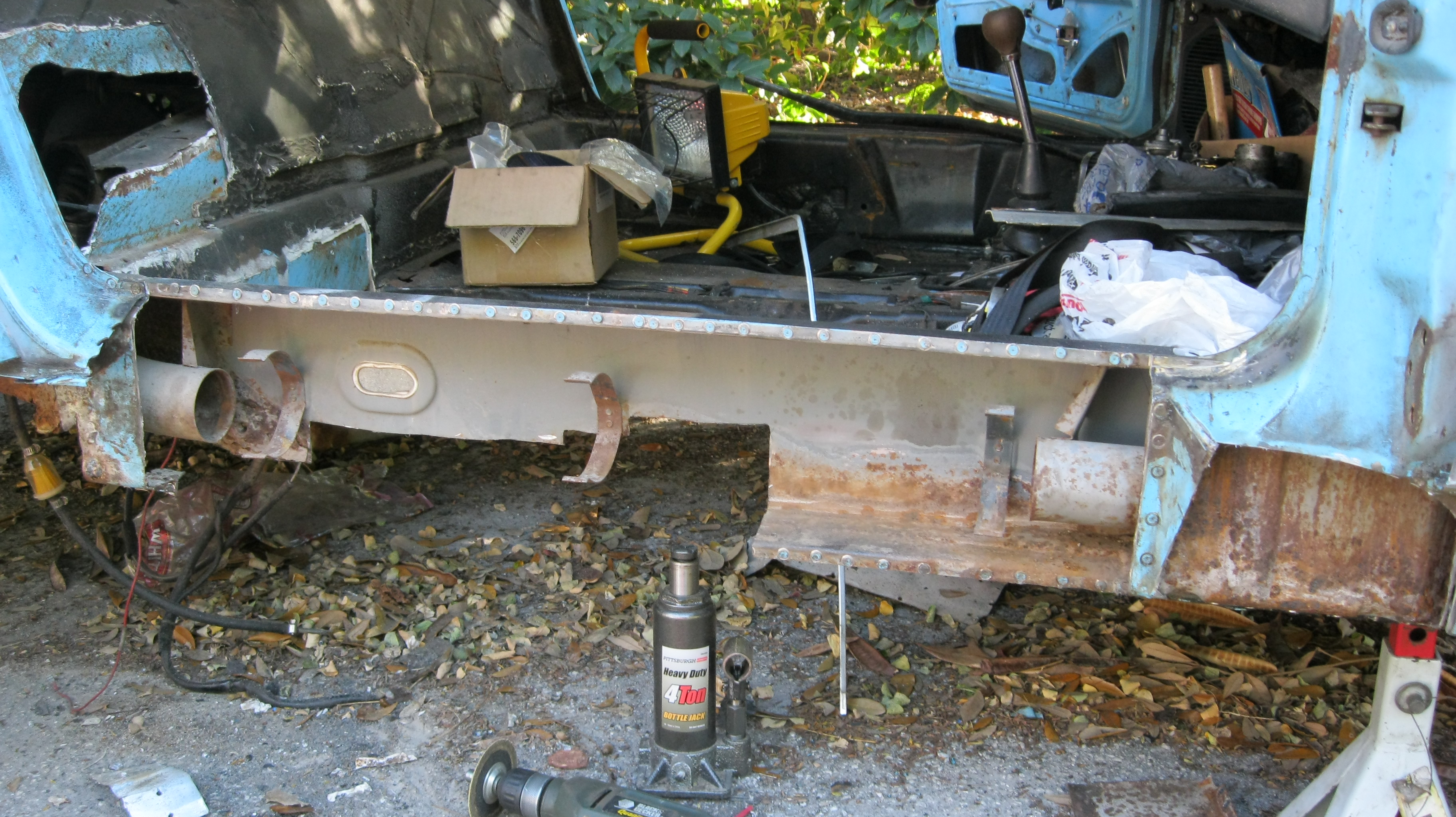

Okay, a little fast forward. I forgot to take pics of the rust before I cut it out, but here is where I decided to begin the repairs. As I'm sure you'll see in other photos, I already made the door bar brace out of some channel steel and some cheap home depot steel turnbuckles (with aluminum body. Like I said, I'm a cheapskate and couldn't find any better turnbuckles anyway. This may come back to bite me in the (IMG:style_emoticons/default/bootyshake.gif) later on, but as of right now its holding at 25 1/8 inches. I don't even recall having to adjust it any other than just getting the turnbuckles tight initially. With the rust this car has, its amazing it isn't already broken in half. I've taken multiple measurements and nothing has changed. Also, I have to note with the rust it had, there was nowhere for me to jack the car up but the rear suspension and front donuts. I know others have supported their cars much better than this, but it doesn't SEEM to be a problem. Sometimes you have to do what you can. Also, this car won't be on a rotisserie - its all being done in my driveway on jackstands.

ThePaintedMan   Okay, a little fast forward. I forgot to take pics...   Dec 30 2011, 09:24 PM
ThePaintedMan   The pieces I fabbed here are made from 18 gauge st...   Dec 30 2011, 09:40 PM
ThePaintedMan   "Hey Jim Bob, you got any rivets laying aroun...   Dec 30 2011, 09:53 PM
ThePaintedMan   Okay, here is the hole in the long behind the fire...   Dec 30 2011, 10:05 PM
ThePaintedMan   This pic is of the bend that goes up toward the en...   Dec 30 2011, 10:10 PM
ThePaintedMan   And this is it. I welded the back part in today an...   Dec 30 2011, 10:17 PM
