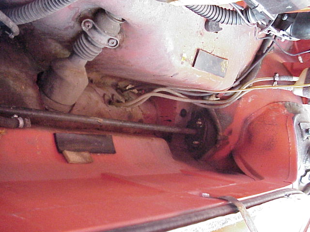

Gint   Tank area passenger There is some VERY minor surf...   Apr 16 2003, 06:05 PM
Gint   Tank area Driver's side   Apr 16 2003, 06:06 PM
Gint   Seal channel surface rust, no biggie.   Apr 16 2003, 06:07 PM
