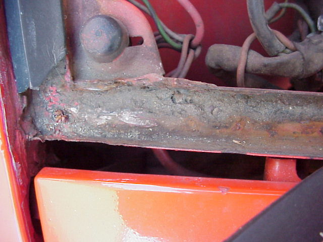

Gint   A little surface rust in this channel. Not entire...   Apr 15 2003, 09:07 PM
Gint   Again, I'm not really sure what it's for.   Apr 15 2003, 09:09 PM

Gint   Another spot of knarly surface rust on the firewal...   Apr 15 2003, 09:12 PM
