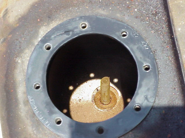

Inside of the tank looks fantastic. Hard to tell with this pic, but no rust at all.
Gotta get back to work now...
