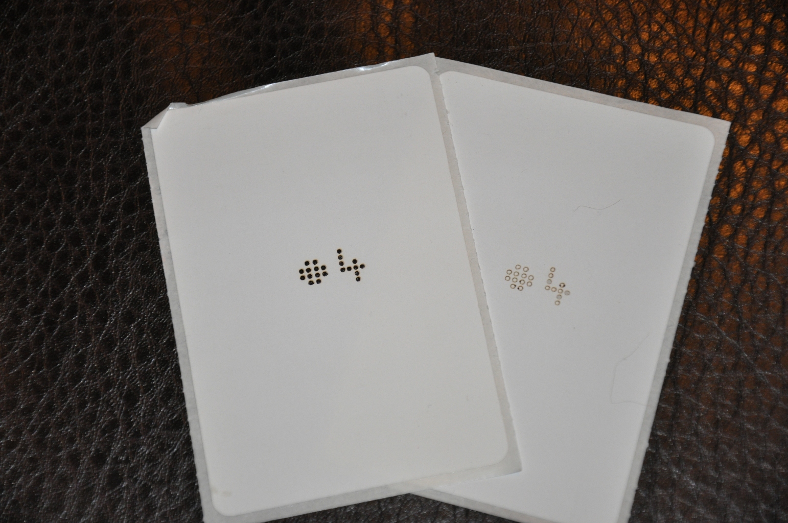

Has anyone had any luck getting replacement door jamb stickers with the vin number and build date imprinted? Years ago, I purchased a replica from Auto Atlanta, but have never been able to figure out how to imprint the sticker with the proper information. These days with computers and Photoshop, there must be a better way than to just try to do this freehand, but it's beyond my abilities,
Any help or information would be much appreciated. My 914-6 was repainted about 20 years ago, and people didn't worry about such things back then (or at least my body shop didn't).

OK, It can be done and I'm working on a fixture to press the semi circles over the intire lable. With a bit of work left to create the rest of the numbers in Corel I will try it on the repro sticker but what you see in this picture is on a lable, one with the backing peeled off in the middle.
but is it legal (IMG:style_emoticons/default/huh.gif) All this is doing is putting the ID sticker back on the car since it was removed or in some other stituations painted over right?

Socalandy   So I think I have what it takes to do this but nee...   Nov 23 2011, 08:46 PM

Socalandy   OK, It can be done and I'm working on a fixtur...   Jan 7 2012, 12:12 AM

Socalandy   I'm really happy this is working, I overlayed ...   Jan 7 2012, 09:12 AM

Socalandy   I'm building a press pack of tubes so I can do...   Jan 7 2012, 05:56 PM

Socalandy   So I talked to my buddy with the etcher. We both w...   Jan 7 2012, 10:36 PM

Socalandy   Update!! I've been looking into a bet...   Jan 20 2012, 04:51 PM

Socalandy   I spoke with Rory yesterday and you can see his po...   Jan 21 2012, 09:28 AM
