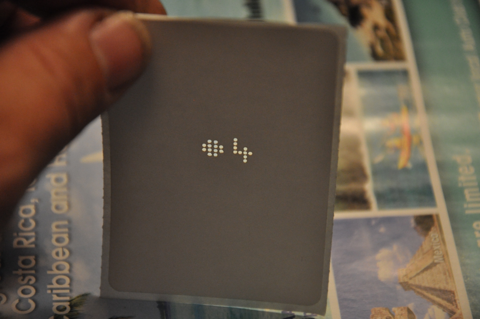

I'm really happy this is working, I overlayed this sample over my 72 jam sticker and its perfect. It will be about the spacing and placement on the sticker and I hope to have one done next week (IMG:style_emoticons/default/piratenanner.gif)
Here's another picture that shows how clean the Laser cuts an the power can be adj. down to even create a hanging chad.

Socalandy   I'm really happy this is working, I overlayed ...   Jan 7 2012, 09:12 AM

Socalandy   repro I got from Ebay, I dont know how many peeps...   Jan 7 2012, 02:51 PM
