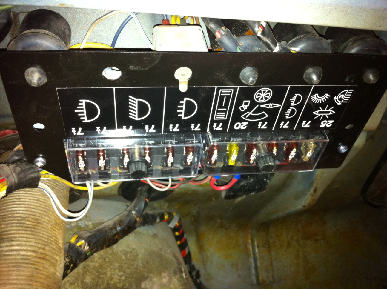

I purchased this fuse box a while ago and just got around to installing it. Super simple.

Harpo   I purchased this fuse box a while ago and just got...   Jan 7 2012, 01:27 PM
3d914   Thanks for the photo Harpo. Do I see three extra h...   Jan 7 2012, 05:38 PM
