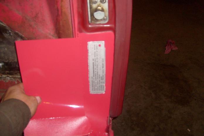

Because of the posssbility of not being able to get stickers I painstakingly washed off the color change on the Raspberry car. After buffing the old finish I held up the test panel I sprayed. I can easlily blend and buff in the jamb and leave the original paint showing with the original sticker. (IMG:style_emoticons/default/biggrin.gif) The match is perfect. But If I could get a new sticker I may.....consider pulling it. Maybe.

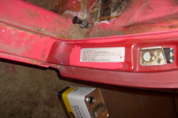

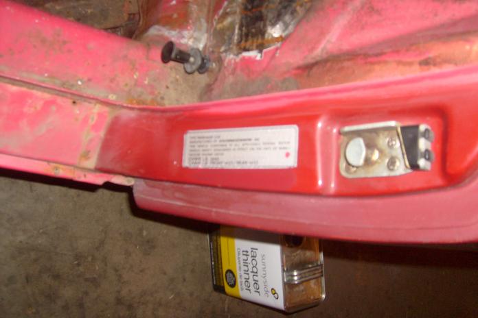

Socalandy   OK, It can be done and I'm working on a fixtur...   Jan 7 2012, 12:12 AM
Cairo94507   Wow you are definitely on to something there. Kee...   Jan 7 2012, 08:08 AM
Socalandy   I'm really happy this is working, I overlayed ...   Jan 7 2012, 09:12 AM
