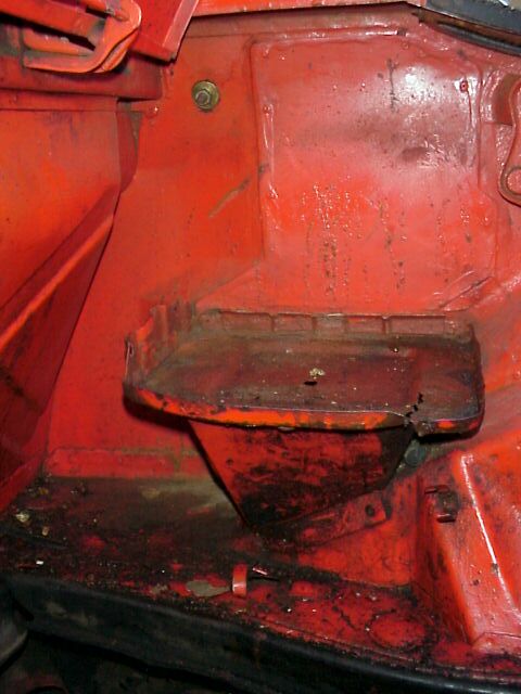

Gint   Now, where was I? Good news! The front trunk...   Apr 16 2003, 06:05 PM
Gint   Tank area passenger There is some VERY minor surf...   Apr 16 2003, 06:05 PM
Gint   Tank area Driver's side   Apr 16 2003, 06:06 PM

Gint   Inside of the tank looks fantastic. Hard to tell ...   Apr 16 2003, 06:11 PM
