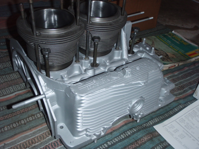

That may be the cleanest engine I hve ever seen (IMG:style_emoticons/default/beerchug.gif)

Mmmm - Nice jugs........Looking very sanitary (IMG:style_emoticons/default/agree.gif)

scotty b   That may be the cleanest engine I hve ever seen :b...   Jan 19 2012, 10:41 AM
bozo914   Mmmm - Nice jugs........Looking very sanitary :agr...   Jan 19 2012, 10:49 AM

jsayre914   Thanks to whomever told me to recheck my injectors...   Jan 19 2012, 11:01 AM
Gint   That bead blasted case is beautiful!   Jan 19 2012, 06:54 PM
Dr Evil   Bead blast! Ah yes, make sure you clean the ca...   Jan 19 2012, 07:06 PM
tscrihfield   Bead blast! Ah yes, make sure you clean the c...   Jan 19 2012, 07:11 PM
Vacca Rabite   Mark painted that case, didn't he. Is it real...   Jan 19 2012, 07:47 PM
Dr Evil   Maybe time to put in threaded galley plugs so you ...   Jan 19 2012, 08:36 PM
