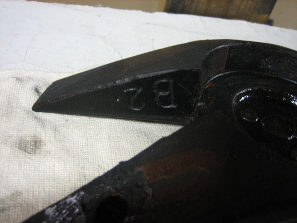

What does this "B2." mean? It's in steering wheels center pad.
http://harrasteet.1g.fi/kuvat/OmaPossu%20I...23.1.12+005.JPG

OmaPossu   What does this "B2." mean? It's in s...   Jan 23 2012, 01:17 PM
Andyrew   No clue. Love the Coupe Quattro though!   Jan 23 2012, 01:25 PM
OmaPossu   No clue. Love the Coupe Quattro though! Btw...   Jan 23 2012, 02:09 PM
Andyrew   Good to know! Regardless its one of my favorit...   Jan 23 2012, 02:20 PM
