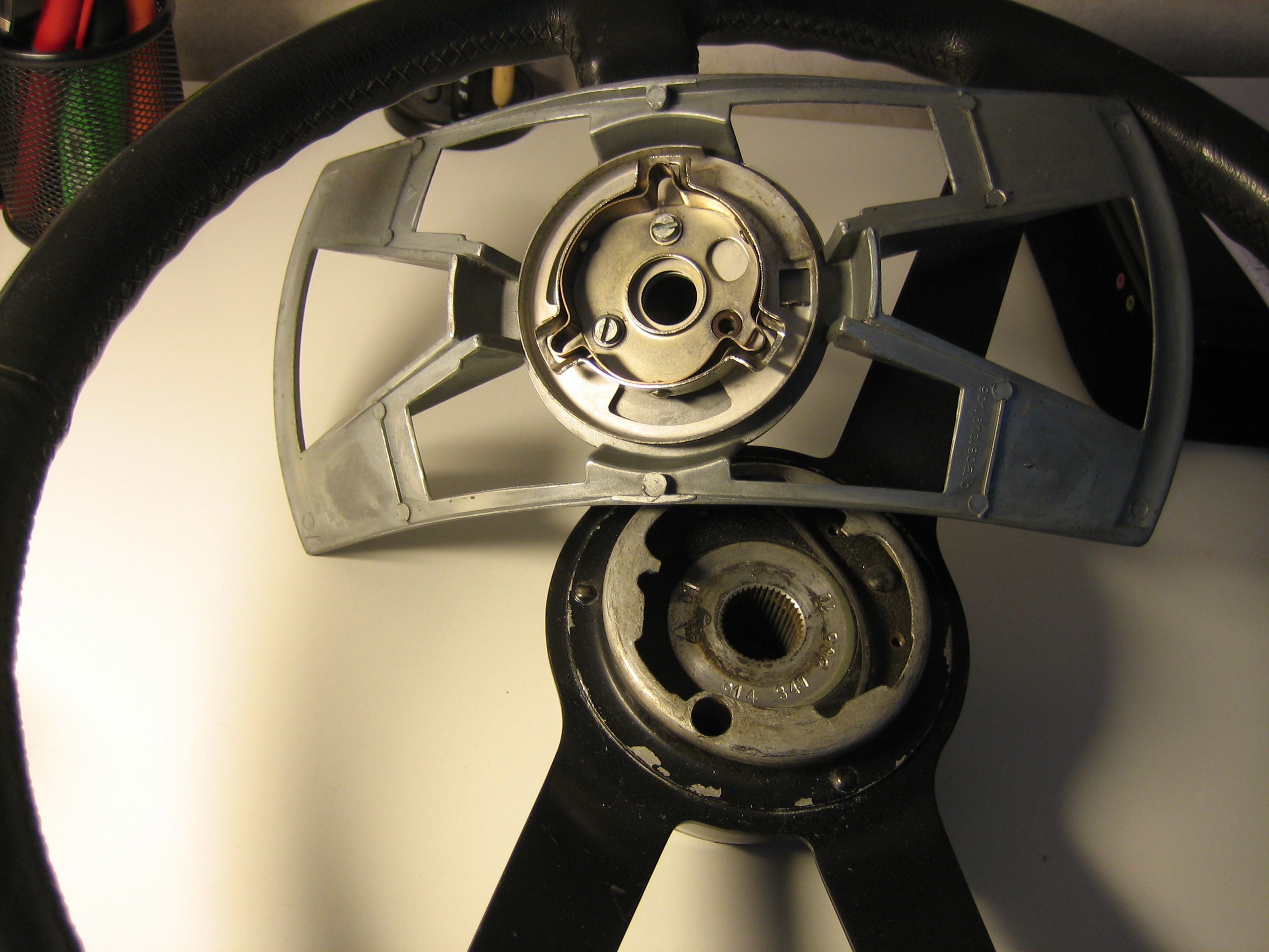

What is right colour to steering wheel metal parts? Satin black?
http://harrasteet.1g.fi/kuvat/OmaPossu%20I...24.1.12+001.JPG

Jan 27 2012, 08:31 AM
I think between steering wheel and horn pad should be something "elastic"? What?

Dave_Darling
Jan 27 2012, 04:38 PM
QUOTE(OmaPossu @ Jan 27 2012, 06:31 AM)
This:
http://www.pelicanparts.com/cgi-bin/ksearc...347-823-01-M100--DD
