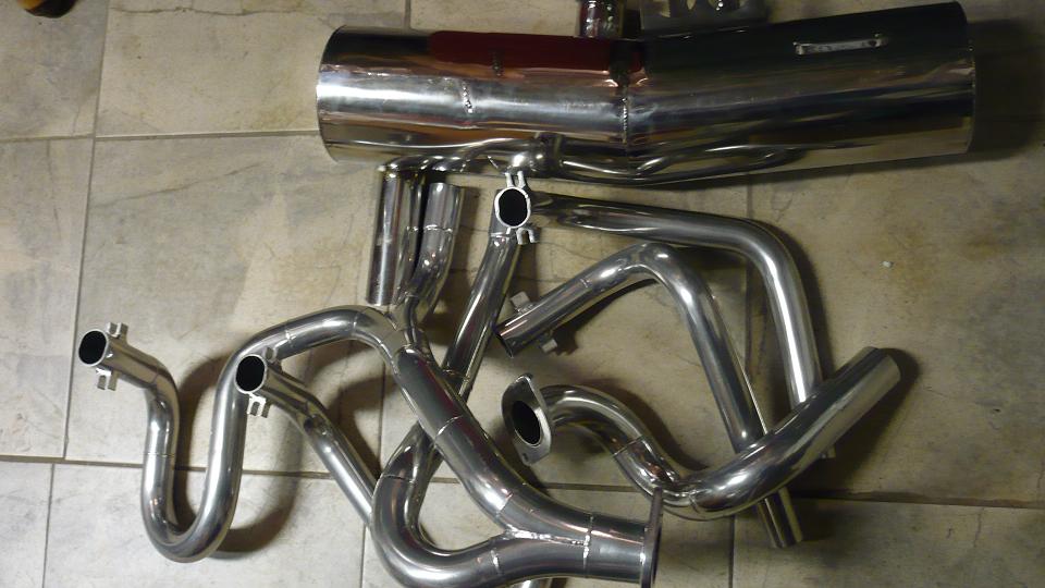

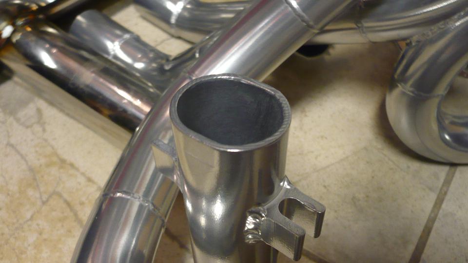

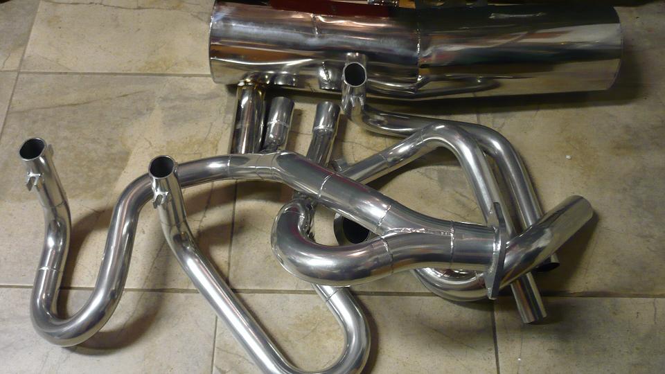

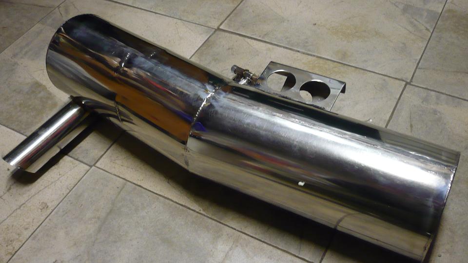

These pipes are excellent Chris. Did I mention that tommorow is my Birthday. Excellent timing
As far as the engine build party, Zach did come and brought Theo (IMG:style_emoticons/default/wub.gif) So we watched movies with our kids and played Wii while eating pizza and drinking beer. We never actually made it to the garage. (IMG:style_emoticons/default/rolleyes.gif) But it was worth it.
(IMG:style_emoticons/default/beerchug.gif) (IMG:style_emoticons/default/beer3.gif) Fun times

jsayre914   OMFG :drooley: These pipes are excellent Chris....   Jan 23 2012, 03:00 PM
Vacca Rabite   Yep, that's art. :jealous: And we did make it...   Jan 23 2012, 06:12 PM
hot_shoe914   Joe, I'm beginning to think you robbed a bank,...   Jan 23 2012, 06:46 PM
