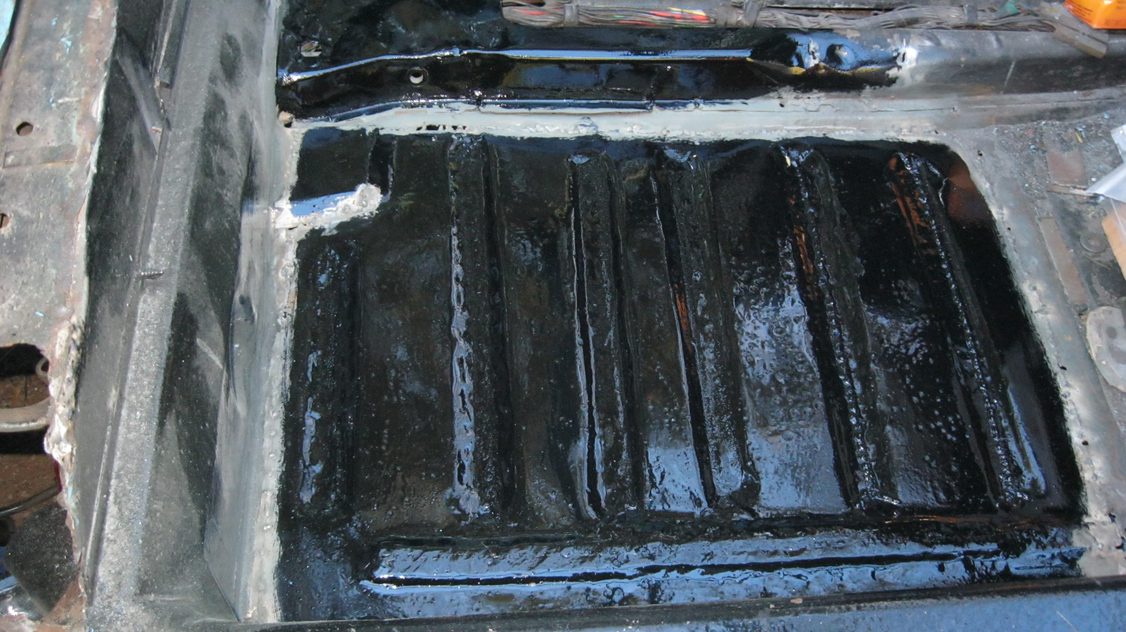

ThePaintedMan
post Jan 23 2012, 10:31 PM
Posts: 3,887
Joined: 6-September 11
From: St. Petersburg, FL
Member No.: 13,527
The floorboard we fabbed. When you see the whole floor, you can barely tell that this isn't a Restoration Design or AA piece. Once I get all the interior cleaned up and painted, I'll be sure to post that pic for your opinions.
