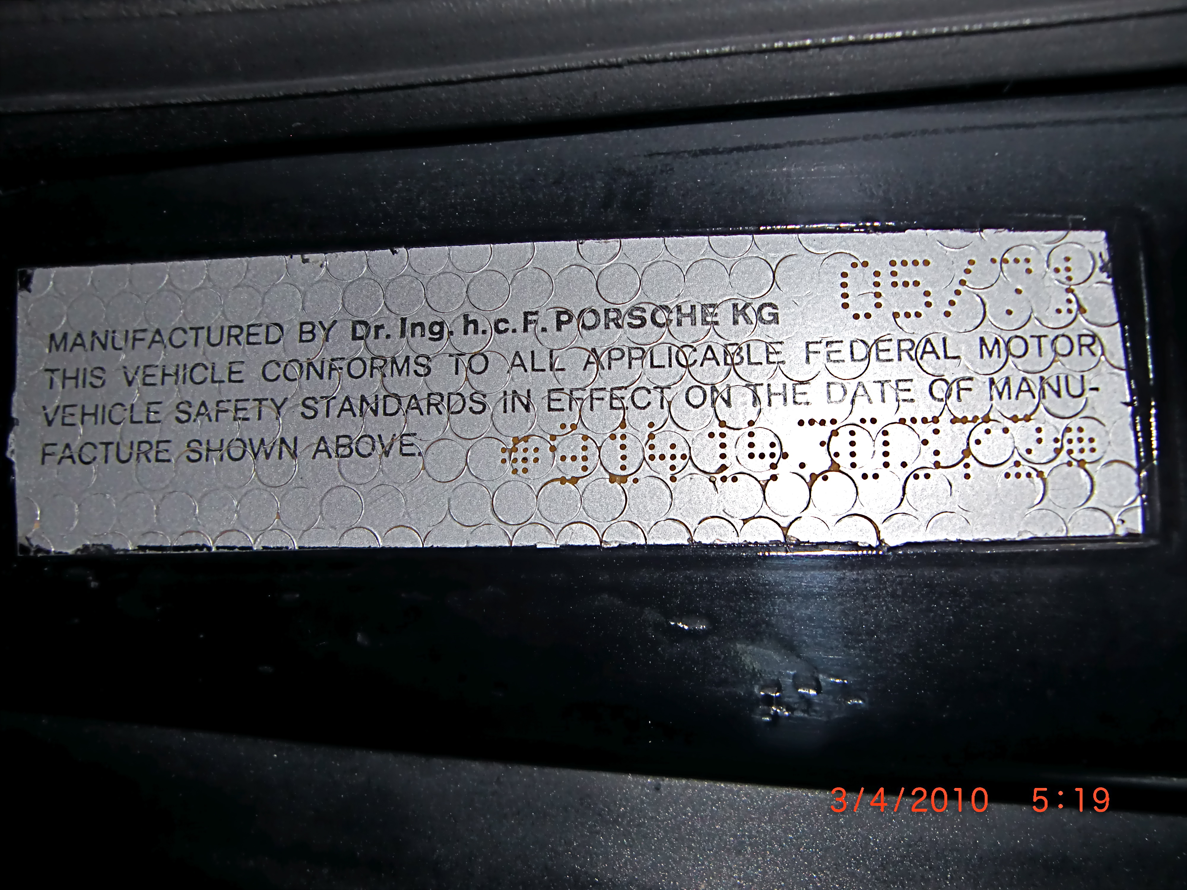

Here is what mine looks like. If need be I can do better when I get some time this weekend.

Socalandy   OK, It can be done and I'm working on a fixtur...   Jan 7 2012, 12:12 AM
Cairo94507   Wow you are definitely on to something there. Kee...   Jan 7 2012, 08:08 AM
Socalandy   I'm really happy this is working, I overlayed ...   Jan 7 2012, 09:12 AM

Socalandy   Update!! I've been looking into a bet...   Jan 20 2012, 04:51 PM
Cairo94507   No problem at all. I like better quality anything...   Jan 20 2012, 06:14 PM
charliew   I thought abought cutting the metal out on a bug a...   Jan 21 2012, 09:10 AM
Socalandy   I spoke with Rory yesterday and you can see his po...   Jan 21 2012, 09:28 AM
