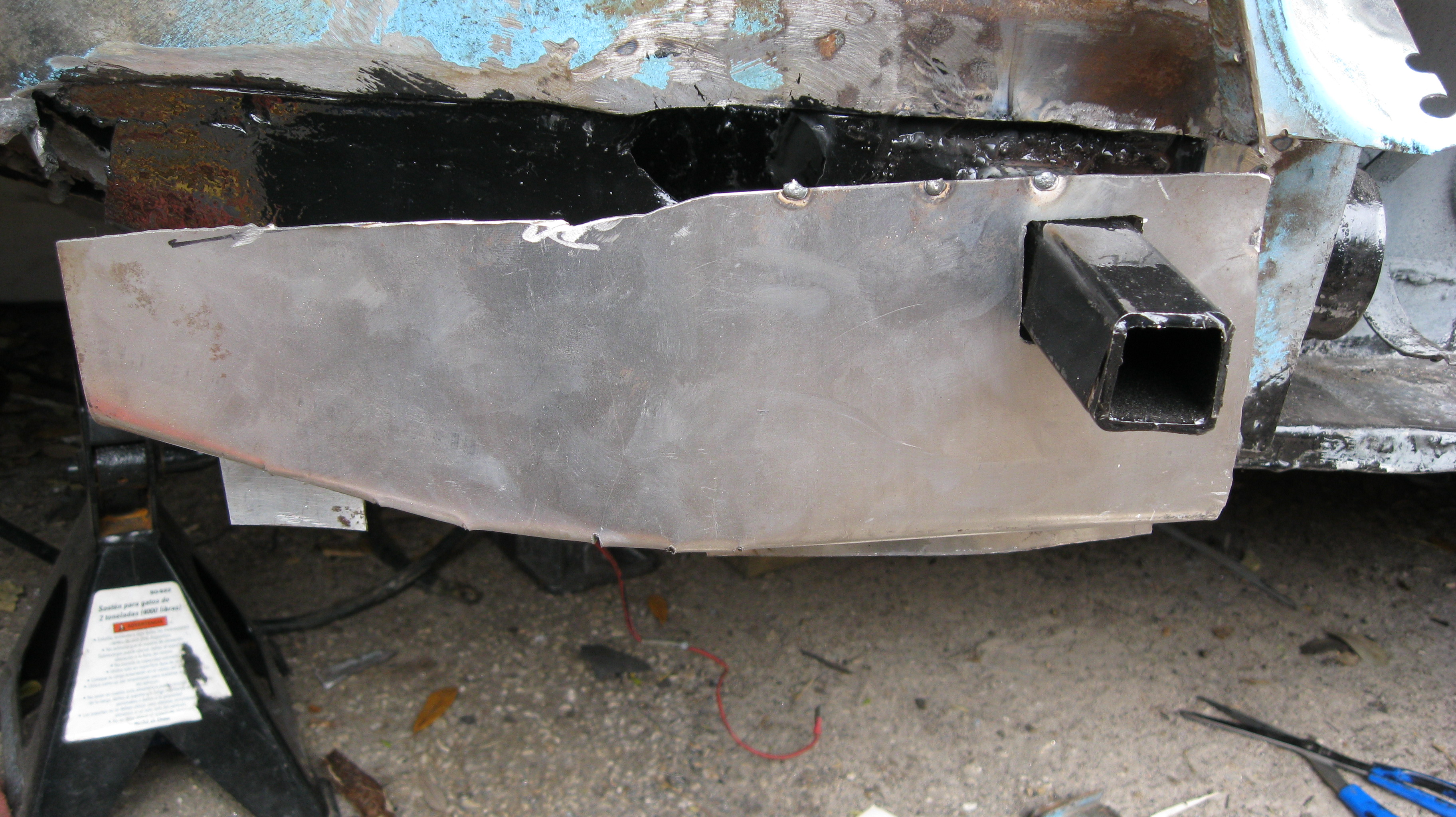

ThePaintedMan   Okay, a little fast forward. I forgot to take pics...   Dec 30 2011, 09:24 PM
ThePaintedMan   The pieces I fabbed here are made from 18 gauge st...   Dec 30 2011, 09:40 PM
ThePaintedMan   "Hey Jim Bob, you got any rivets laying aroun...   Dec 30 2011, 09:53 PM
ThePaintedMan   Okay, here is the hole in the long behind the fire...   Dec 30 2011, 10:05 PM
ThePaintedMan   This pic is of the bend that goes up toward the en...   Dec 30 2011, 10:10 PM
ThePaintedMan   And this is it. I welded the back part in today an...   Dec 30 2011, 10:17 PM
