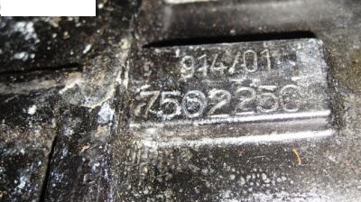

OmaPossu   I found this number on the side shift transmission...   Jan 29 2012, 01:00 PM
Niklas   I think it is for a 1972. Niklas   Jan 29 2012, 01:10 PM
Jeffs9146   Along the top of the transmission stamped into the...   Jan 29 2012, 01:20 PM

Jeffs9146   Along the top of the transmission stamped into the...   Jan 29 2012, 01:21 PM

OmaPossu   Ok, I'll check the transmission numbers next t...   Jan 29 2012, 01:42 PM
Jeffs9146   You might want the contact this person they have a...   Jan 29 2012, 05:28 PM
