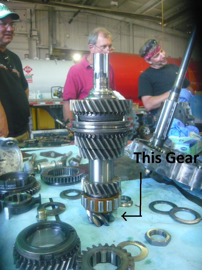

I had something like this but it would only manifest under load. It turned out to be excessive wear on the gear on the mainshaft that interfaces with the ring gear on the differential. Dr. Evil told me it was not repairable and would grow worse with time but wasn't catastrophic.
