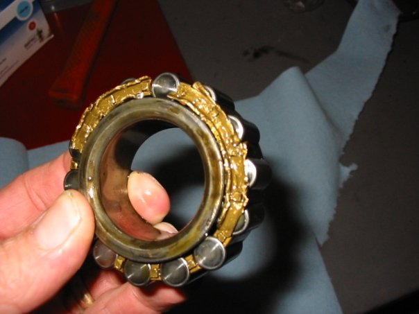

I also had the same problem and it was the same bearing Jeffs9146 is talking about.
Just above the pinion.
