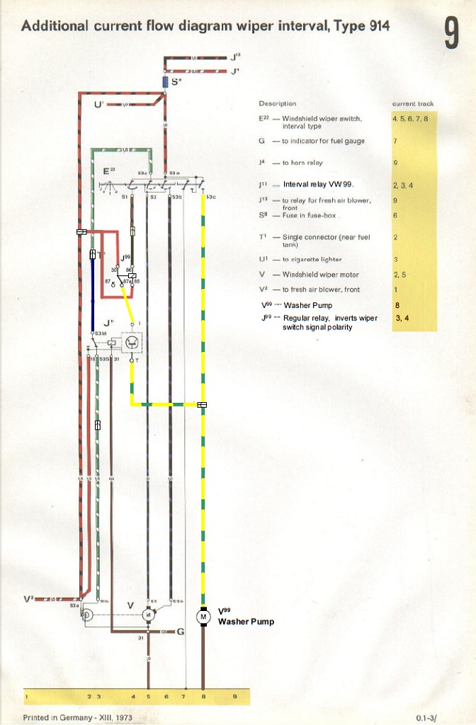

I am trying to figure out what I have here. I noticed that there are two different wiper switches available. 70-72 and 73-76.
This is the one that is in the best condition.
Notice that it only has four pins on the left side.
I have already attached a switch that I got from davep, which will trigger my electric washer pump that I plan to install.
This is the second one that I have. Being in worse condition out of the two.
It has five pins on the left side. The extra one being a brown, which is ground correct?
The switch is also different in that the plunger that would activate the washer fluid has an electrical contact
I am running a wiring harness from a 72 car. Which switch do I need to use? Am i missing pieces from the first switch maybe?
Im stumped here...

Here is the best solution in my opinion, using the new VW programmable relay.
If you add a delay relay to your wipers, this is the same amount of work and you get all the benefits of modern electronics with variable delay without changing the appearance.
