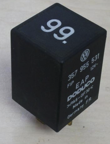

QUOTE(Valy @ Feb 7 2012, 04:16 PM) *
Here is the best solution in my opinion, using the new VW programmable relay.
If you add a delay relay to your wipers, this is the same amount of work and you get all the benefits of modern electronics with variable delay without changing the appearance.
Do you have a link for one of those VW relays?
or is it just something like this..
